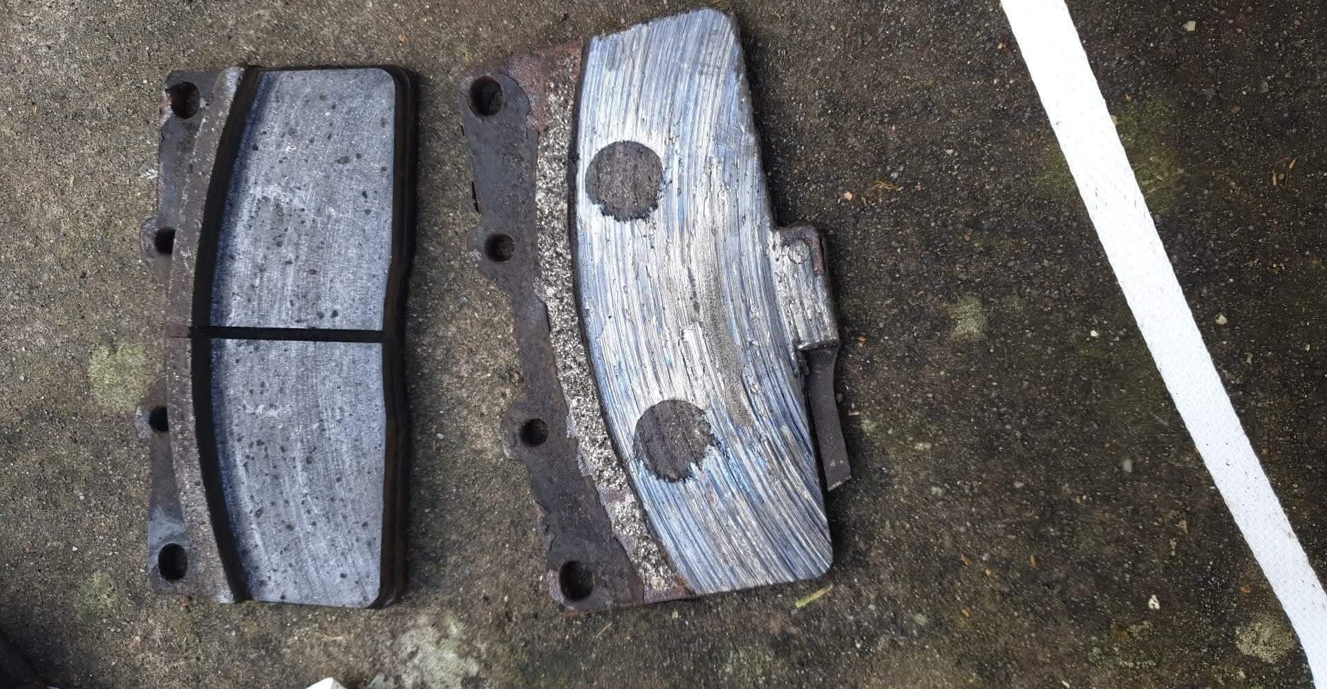

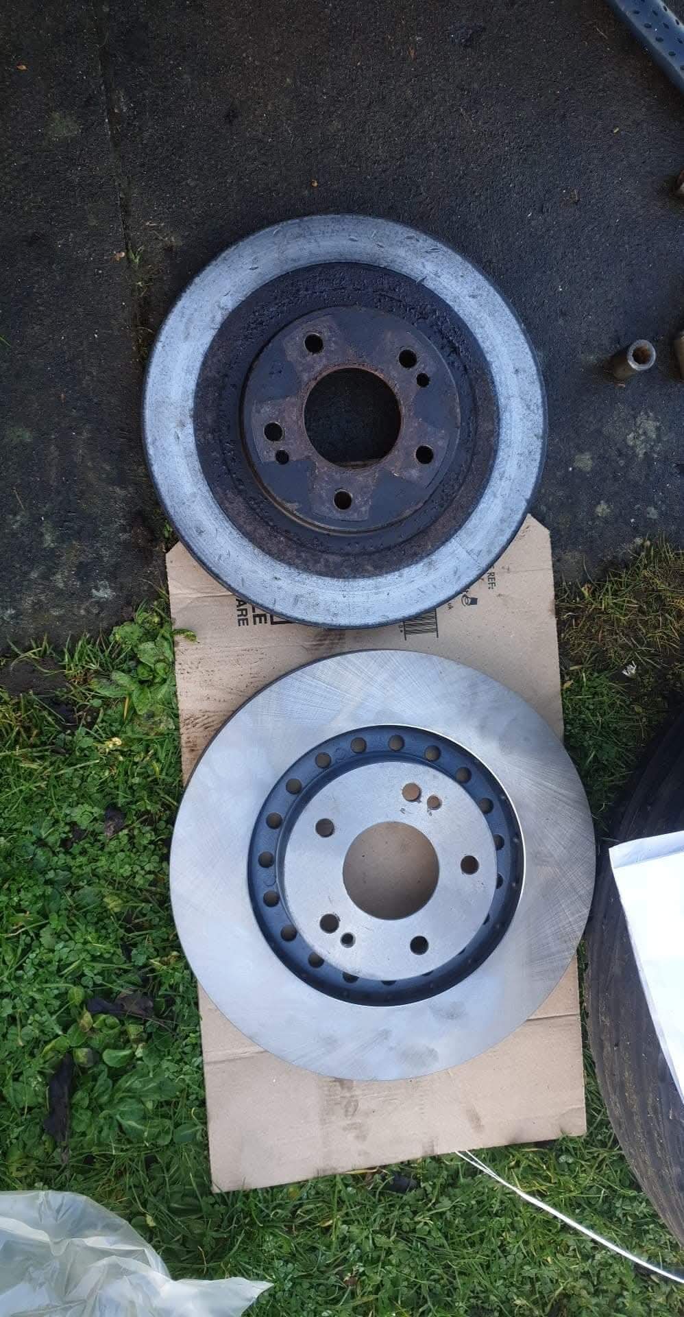

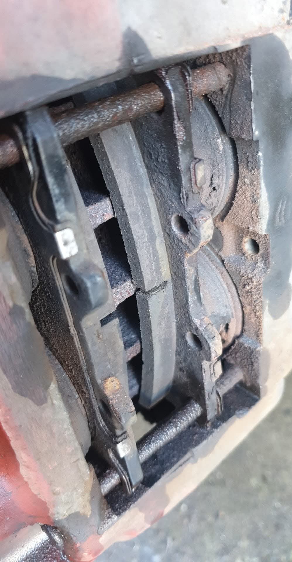

Welcome, just on the brakes, not all mk1 have the smaller, i would measure them if you can before buying, when I first got mine someone put the smaller discs on but I had the bigger brakes which lead to alot of fun getting the discs off the car, cant help with where to get them, but worth noting.
Euro3spreformance seem to say they have a kit, but never used them, so cant say what they are like
A few pics of my brake troubles, if you look at the old disc you can see the hammer dents all over it :rofl:
