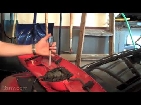

Have seen a great youtube video on how to replace the faulty switch if it’s not working
Yes that’s a good video I used 3 spoilers to make one lol
