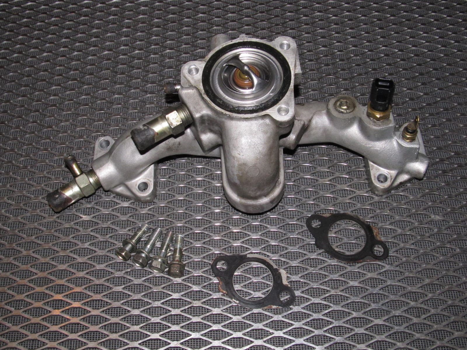

Hi pal. Thank you. Both bottom radiator sensors have been replaced. Its actually the water temperature sensor below the thermostat housing need. I will post a picture with this message. Thanks again :+1:
Then you need;
MD149338 which is about £35 plus shipping.
Theres also a Mitsubishi OEM part 1308A012 which is much cheaper, of which you can also find aftermarket versions of like Lucas on eBay UK.

So where is the water distribution housing.? I can see the thermostat housing but no sensor
To the right of the thermostat on the housing under the coil packs there is usually 2 or 3 sensors, depending on year of the engine one one of these may have a bung in.
