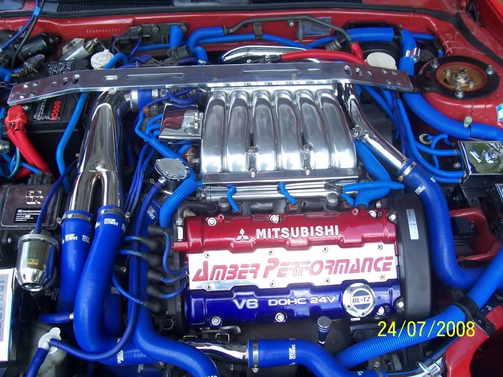

That’s a nice looking engine bay you have there Scott.
Will keep looking for a TT as that’s what I really want.
Thats my old mk1 @nuttyfisher,working on getting the new mk2 asgood but along way to go.ive owned both na and tt the best i can describe it is:the na is a great drive,the tt is an EVENT!
