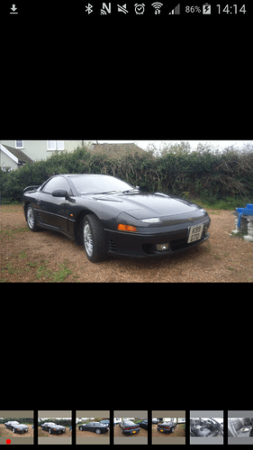

Hi just found this site, picked up my GTO on Tuesday. It’s an N/A Auto mk1. As with any 25 yr old car it has some issues. Rear aero spoiler doesn’t work. I can hear the relay click but doesn’t move. Also the cruise control doesn’t work. Any help on these appreciated.
I am looking forward to a good detailing session on my day off next week as she’s in need of a good clean!
Hi and welcome , looks a tidy motor .

I saw this advertised the other day and think it is my my cars sister lol x I was very tempted to buy it but refrained. Two grey gtos can sit together lol :smiley:

Did you buy this from Alistair off Gumtree by chance ??

I bought the car from an older gentleman named iain near ipswitch. It was advertised on ebay. Be nice to find some history on the car
