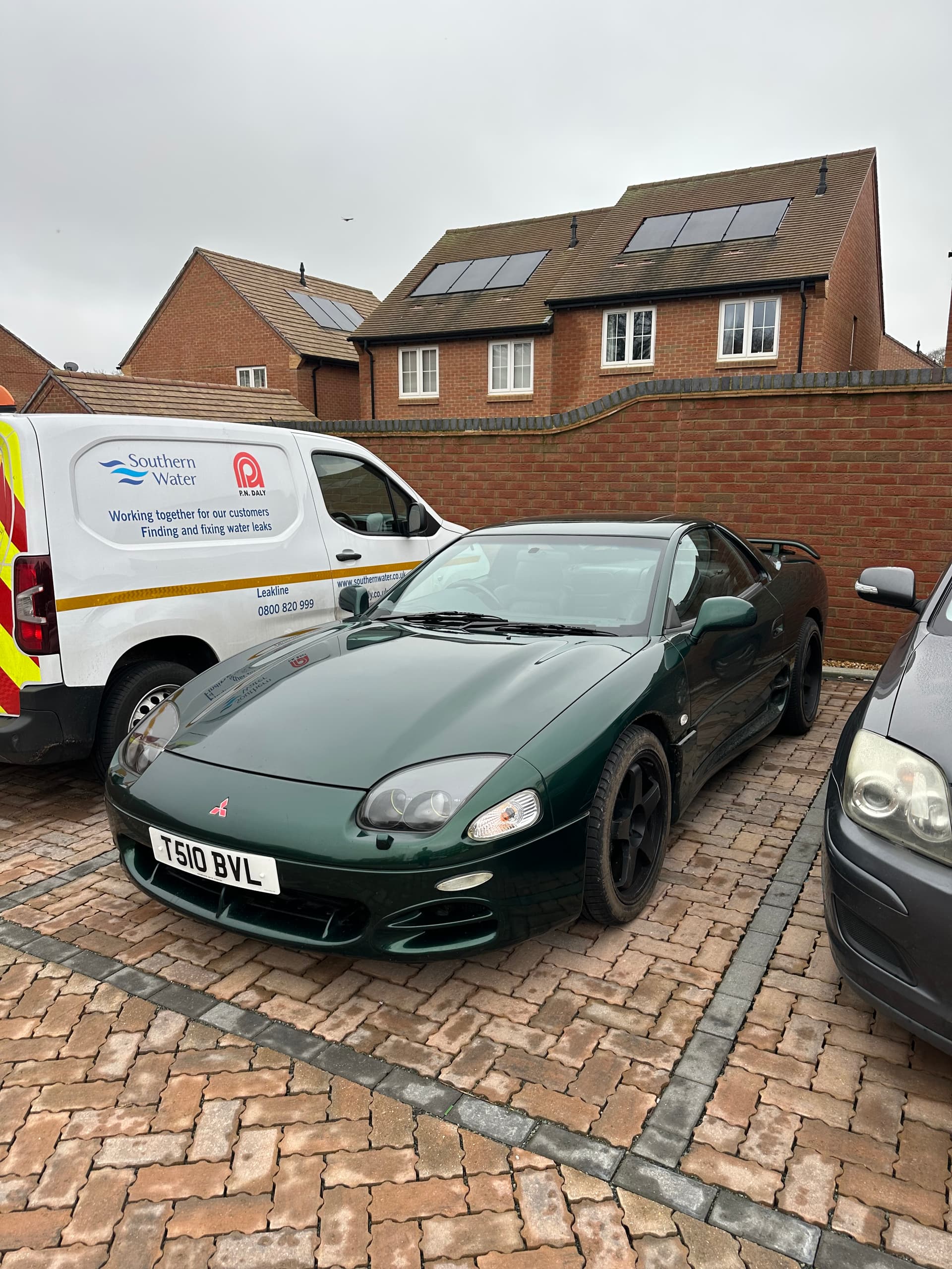

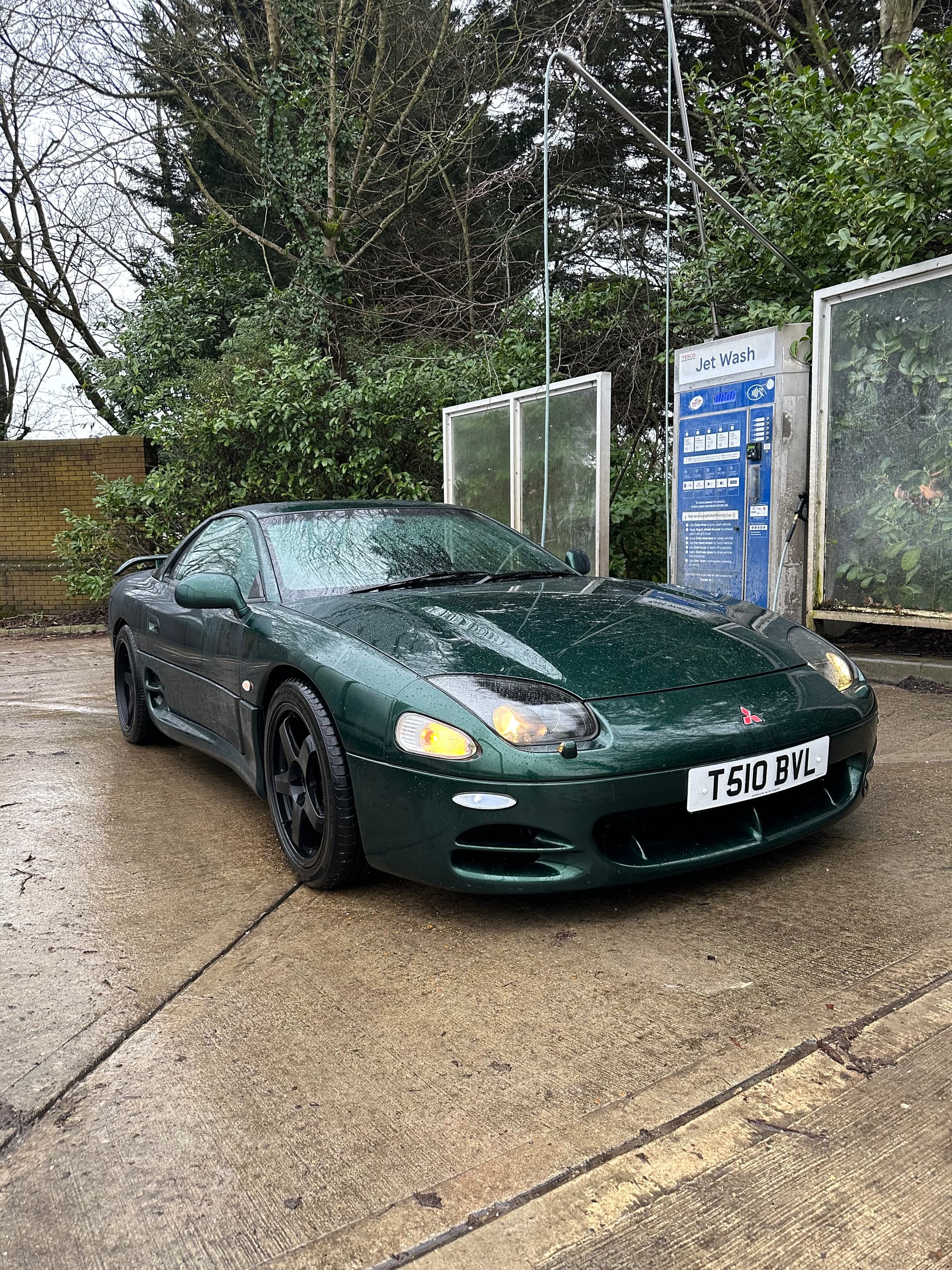

Just picked up my 3000gt VR-4 yesterday and I’m over the moon with it so far - I’ll post a couple photos below - let me know if you recognise it. Be nice if I’ve bought a stinker but seemed good to me!

beautiful car welcome

Beautiful car :raising_hands:

Welcome, and gorgeous car!

A nice motor - looks great.

Beautiful looking car, welcome to the club and hope to see you on some meets.
Welcome aboard Nathan. Looks like you’ve got yourself a beauty - well done!

A great looking machine! Welcome! :grin:
