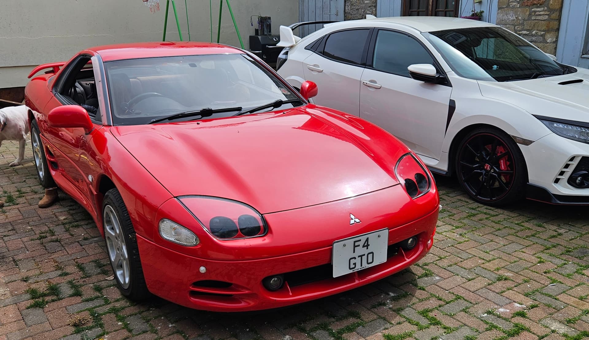

Hi Everyone,
As of today im the proud owner of a GTO TT! Got it as a second car to tinker with a little so definetly see me floating around the ‘how on earth do i…’ area’s.
A little about the car as far as I can tell so far…
It’s a Jap car, 100k KM and came from an owner who loving cared for it for 19 years, might even be on the forum somewhere?!
Got a couple a known issues to work through the most pressing being steering wobble at 65mph and also under breaking. My assumption is likely it needs lower front bushes and ball joints.. Probably a wheel balance and alignment to.

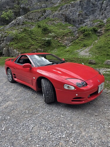

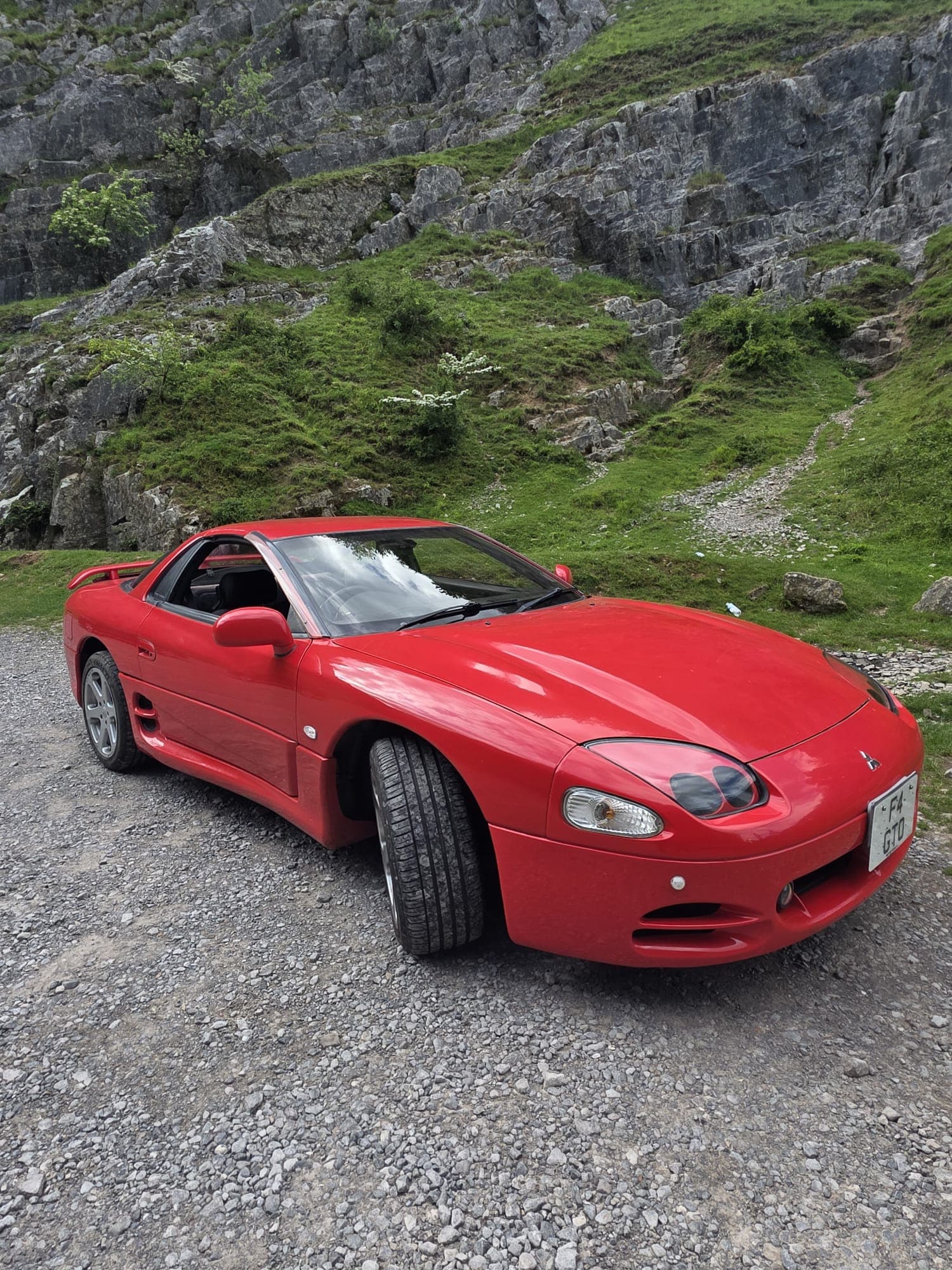

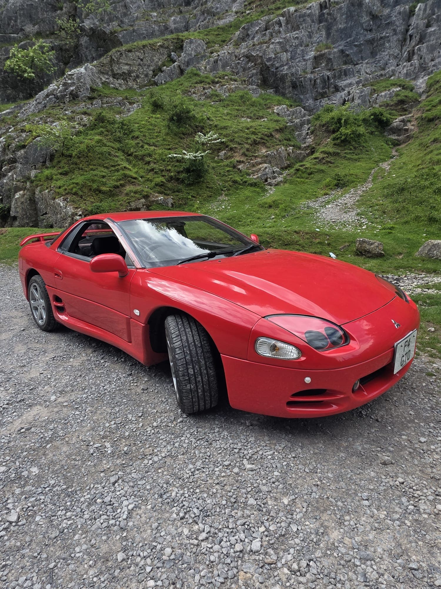

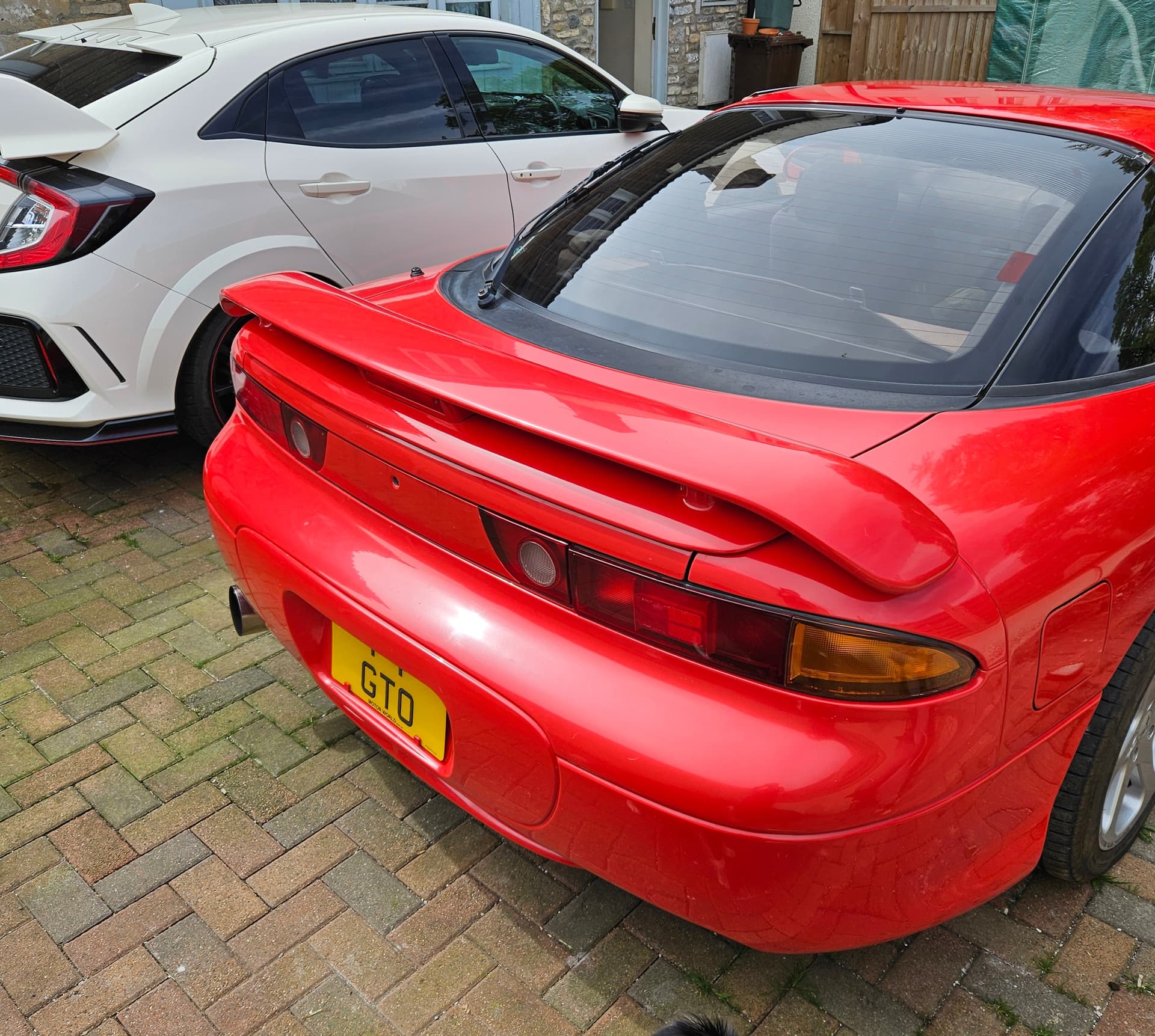

Heres a couple pic’s

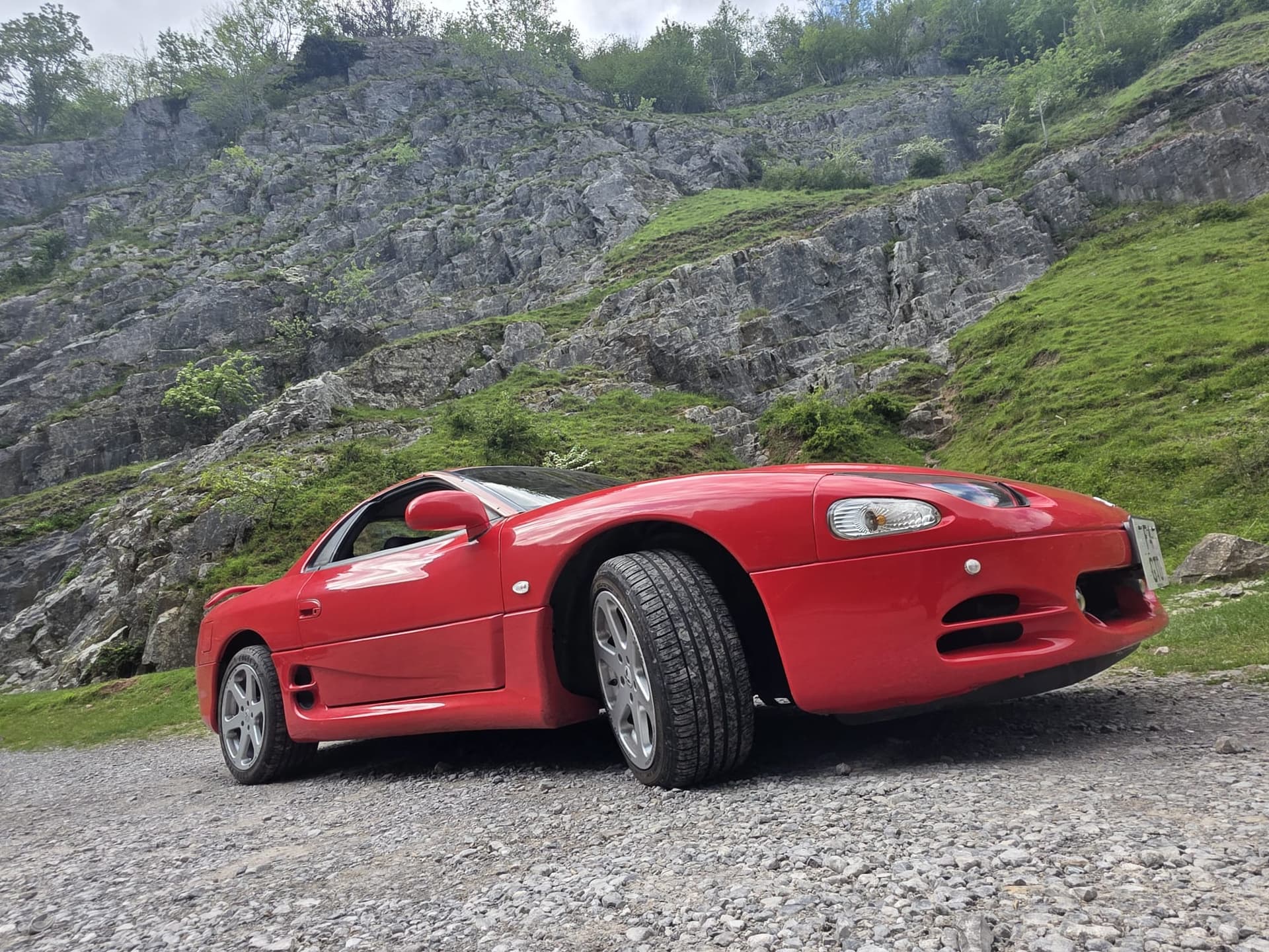

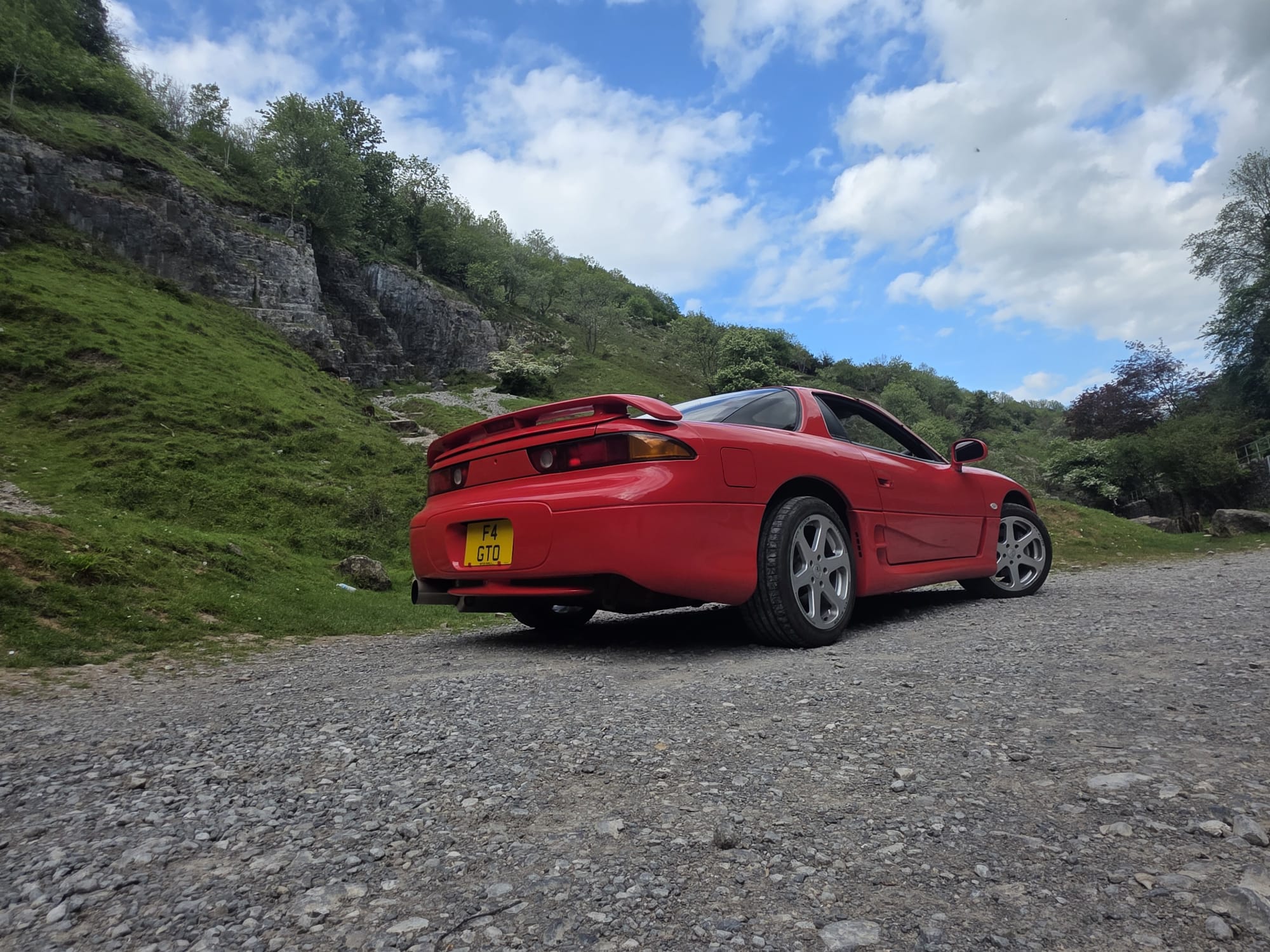

A few more pics but proper ones this time
