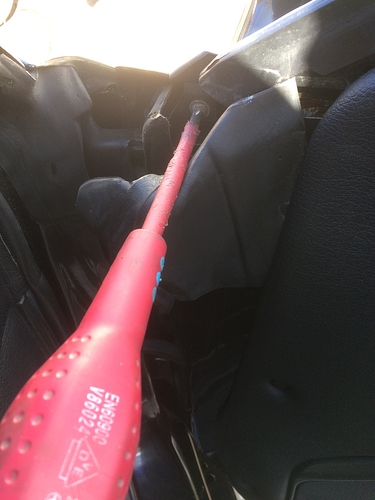

As I used this guide to replace my weather strips, I found this guide a little lacking. So to dot the i’s and cross the t’s.
There are two securing screws for each strip
Then you got to peel out the inner rubber triangle from front of window, to access another screw.
Then I carefully slid a screw driver in behind the strip from the back window side and (with some force) popped the strip out.
Refitting the new strip required quite some downward (and slightly outward force) to slide it home.
Hope that helps.
