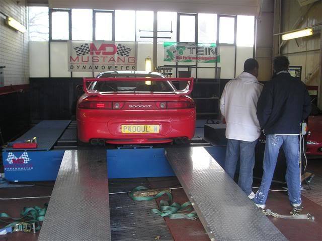

Really enjoyed meeting you all and spending the day with such a fine array of GTOs (and variants :wink: ). Can everyone please post their info for reference? My uncorrected peaks at the wheels were 306.6 bhp @ 6189 RPM / 87.3 MPH and 306.5 lb-ft @ 3841 RPM / 54.4 MPH. The MPH values seem off, so I’m not putting much faith in the RPM values. The parasitic loss for my car was measured as 112 bhp (or 30%) during http://www.the-matthews.com/dyno.html, so adjusting my wheel measurements accordingly works out to 418 bhp (or 438 bhp using the percentage) at the flywheel. I posted http://www.3si.org/forum/showthread.php?t=412529 about the AFR discrepancy (the dyno operator interpreted the tailpipe sniffer WB02 values as being very lean despite logged NB02 values being very rich).
I’m not convinced that corrected values make sense for forced induction engines (see http://www.sdsefi.com/techdyno.htm, for example), but FWIW, here is my corrected trace:

Jim,
CVR4 have said similar to me when i posted my readouts, their correction factor seems waaaaay out.

they are using some wcf (weather correction factor) in the dyno, my bhp on there graph is 383, without the wcf it is 404! they said it calculates the air density, humidity and air temp, to give a true bhp figure!
i dyno’d it in november last yr at engine advantages at 410 bhp, now at 404 bhp, so i rekon it’s pretty accurate, even if there calclations are a bit off!!!

The dyno operator estimated 28% drivetrain loss at peak power but applied the factor incorrectly when calculating the flywheel horsepower figures he typed into the Comments section (the Maximum Power and with WCF figures are at the wheels). For the AWD cars, he added 28% to the wheel horsepower figure rather than subtracting 28% from the flywheel horsepower. If the drivetrain consumes 28% of the power produced by the engine, then 72% of the power reaches the wheels.
wheel horsepower = flywheel horsepower * 72%
flywheel horsepower = wheel horsepower / 72%
So:
315 wheel / 72% = 438 flywheel
[quote] got a peak of 224bhp@6148rpm/102mph at wheels
with 287 bhp at the flywheel[/quote]
224 wheel / 72% = 311 flywheel
265 wheel / 72% = 369 flywheel
I don’t know what correction was used for your RWD car, but it won’t make as much difference in your case since the parasitic losses are much lower.
There are two ways I can think of to validate dyno flywheel estimates: http://www.stealth316.com/2-calc-hp-et-mph.htm and http://www.stealth316.com/2-air-fuel-flow.htm. Both work out about right for my car (112 mph traps and 90% IDC on 450cc injectors each indicate approximately 425 flywheel horsepower).
Jim,
They didnt give my wheel figures i dont think. They have now totally confused me with this. What do you reckon this should read?
http://i22.photobucket.com/albums/b319/miller_63/PHTO0148.jpg
http://i22.photobucket.com/albums/b319/miller_63/PHTO0145.jpg
http://i22.photobucket.com/albums/b319/miller_63/PHTO0145.jpg[/quote]
I’m hoping they haven’t got me chasing ghosts with such a low power readout from my own car. It car seems quick to me, and I know for definate that it pulls away from a stock 280bhp Skyline GTS-T and is just a tiny bit slower than a 230 wheel horsepower RX7. :twisted:
Going on multiplying your wheel figures by .72, that works out at a 340bhp Legnum. :?
Going on multiplying your wheel figures by .72, that works out at a 340bhp Legnum. :?[/quote]
which its definitley not! They have put some calcs in and not given me my wheel figures which im trying to decipher from that graph. Engine torque and Engine Power…is all the graph shows.
Can some one else look at their graph and try and see where my wheel horsepower is worked out?
