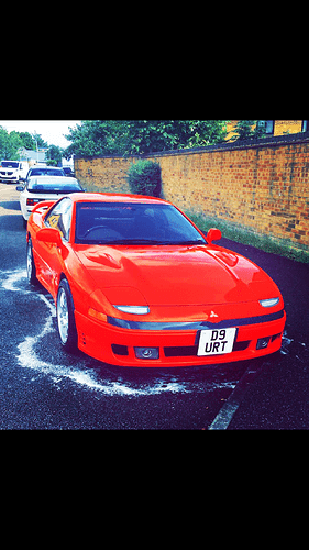

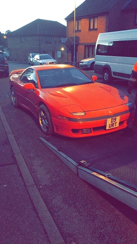

Morning mate, I’m from South East (Luton, Bedfordshire) Thanks for the quick reply, she’s no longer cranking over. I think the battery has died, did try jump starting it yesterday off the Porsche but it wiped the Porsche battery out too :joy::joy: will get a battery charger and leave it plugged in for a few hours and then try for spark! Here’s a few pics of the GT and the Porsche :+1:t4:
