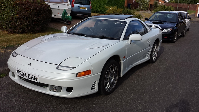

Looking to buy this GTO which needs a bit of work
As Justin said I would find the source of the blue smoke first before putting any more money into it. Could be a simple fix, could be terminal for the engine. On the whole though not too bad.

Blue smoke…well, it’s nothing dire. Either way, it sounds like it pulls well. Your culprits will be head valve seals, or oil control rings or turbo seals. Don’t worry too much, take your time with it, and eliminate one thing at a time. Start with a compression test to see where you are.
She looks a beauty - well done, and good luck with it.
